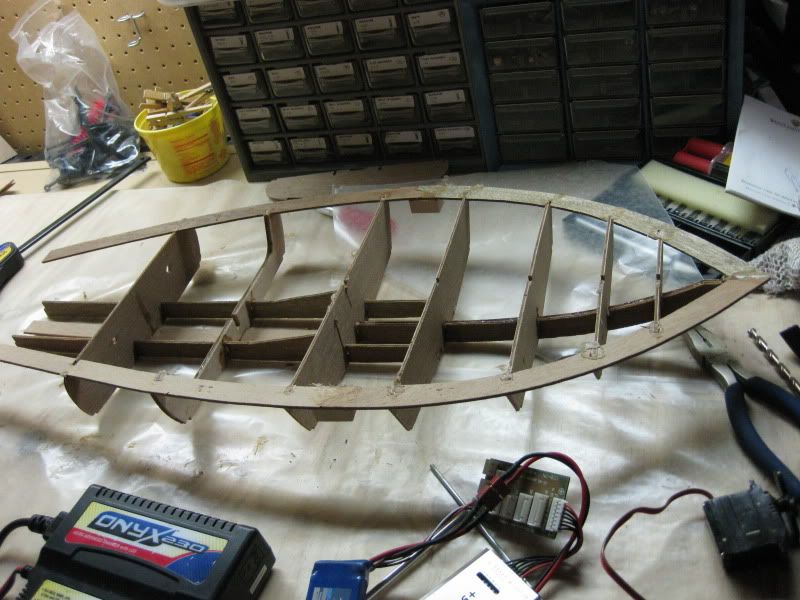

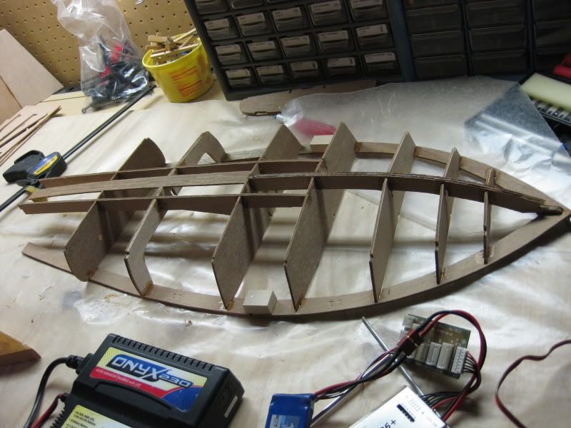

    Started this build the other day. Off to a good start, but it all goes slow from here. This is my first build, so i hope it turns out good!
    Here are some pictures of where i am so far, I have put about 1 hour of actual working time in to the build so far.

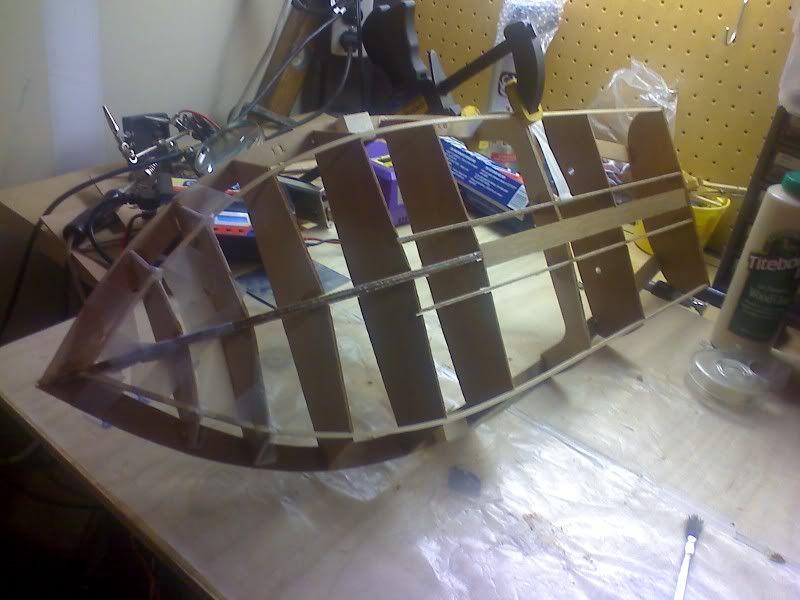

              Here it is as of tonight, got the chines on, i am debating on if i need a ... cant think of the proper name right now, but one of the fins that goes in the middle of the boat to keep it from spinning out... I think it might get squirley, but i can always add turn fins to the back

                    Very impressive so far, now comes the hard part is the hull aligned and applying the plywood, balsa then fibreglassing the hull.
                      I believe the word you are looking for is "skeg". On our SK Jr. build we did not have a skeg but on the 28in. version(just scaled the plans up from the smaller one and made some mods) we did have a skeg. On the bigger hull we ended up running a 3.5 K&B outboard. The skeg will surely keep the boat from sliding in the turns.
