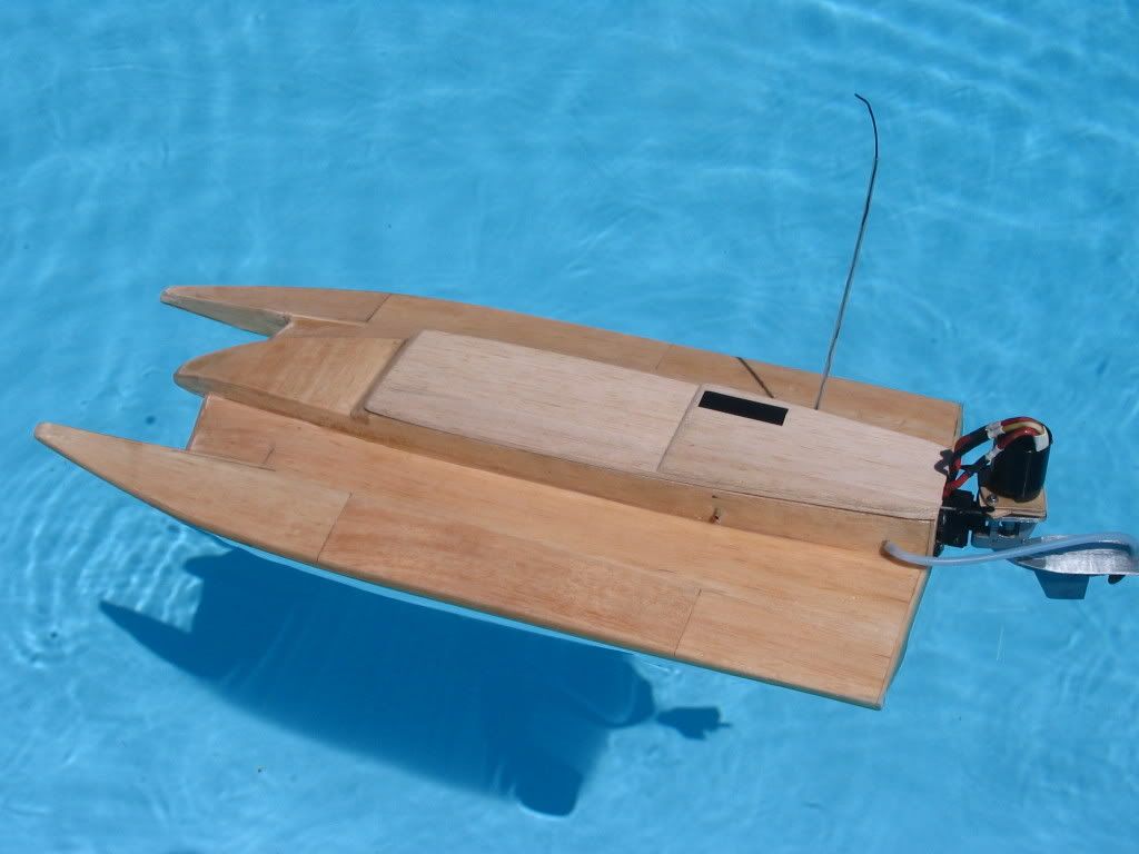

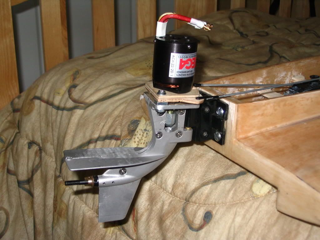

      i have done two. i used a piece of steel and wood to make a motor mount and have them extended for the servo arms. then bored out the middle for the collet and chopped off alot of dead weight.

        Not sure how much help this will be, but when I converted my Lawless 3.5 drive to Brushless, I just made a plate like the one shown in this picture and spaced it up on standoffs... Works perfectly so far... Just make sure to keep the cable lubed and also flood the motor with Corrosion-X at the end of the day...
        K&B Outboards have been the FE standard for conversions for some time... I'll see if I can get one of my club-mates to post some pics of his. He has several that work great...

          Hi guys
          Thanks for the great pictures. They will be very helpful for me to prepare my shopping list for MECOA.http://forums.offshoreelectrics.com/...et2/banana.gif
          They all look great and the the servo connectors are very interesting.
