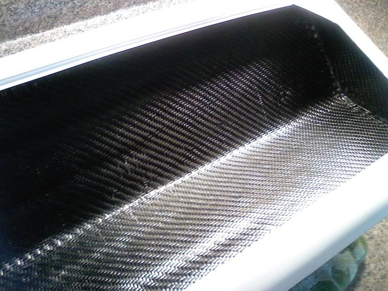

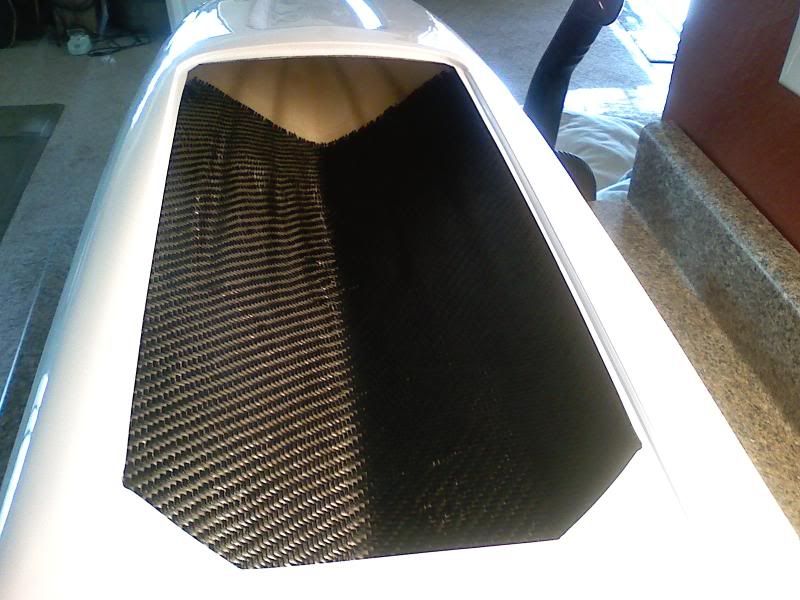

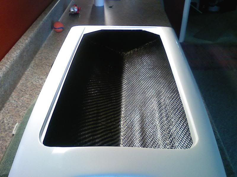

                she turned out nice... the CF frays like mad but she looks pretty neat... structurally it has made a huge difference... pretty stoked with the results... the roller is the way to go... cheers bonewar
                overall a decent first attempt... harder to lay than fiberglass, thats for sure...

                  Oz,
                  The carbon work you did looks sick mate.
                  Well done.
                  If your worried about the frayed edges , just get a little brush with some black paint
                  and paint the edge of the carbon , to achieve the perfect look.
                  A little trick with the carbon is to use masking tape on the edges to stop it fraying.
                  Then when the carbon is almost cured you cut the tape off for a very clean look.
                  Nice work mate.
                  Bonewar

                      cheers lads... it ll look good goin 50mph anyway :) good from far, far from good - that kinda deal... :)
                      not to worried about the fraying... i stoked how much strength the hull has gained... the bottom was flexy as before... now she s golden...
                      bonewar = when your saying you 'cut the tape off' after she has cured for a bit, are you cunnting with a exacto knife or something similar ?? that thread on CF somewhere here was a great help... thanks to yaself and all of the others - great info..
