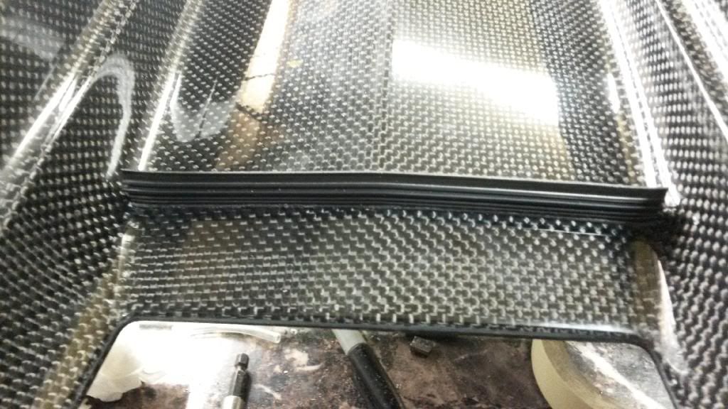

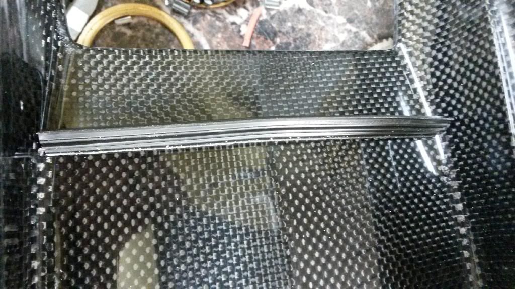

                Use a wind shield wiper, 1 inch from the front on the bottom and also some blokes in germany are using them 1 inch from both the bottom and top. The attached picture isnt mine, just one I saved as I am currently building mine

                  Thanks. Does it help yours or have you run it yet? Correct me if I'm wrong but yours in that pic looks further back than an inch?

                    I haven't set mine up yet, Yeah I was advised an inch, but that pic looks about 2-3 inches. If I were you id just tack it in place with 2 dots of quick set. See how it goes.
                    I will be doing a zig zag patten the whole way on the bottom of my Cheetah, just try different things out.. I am trying to break the 75mph barrier so I will be trying a few different things to prove to people this can be a fast hull.

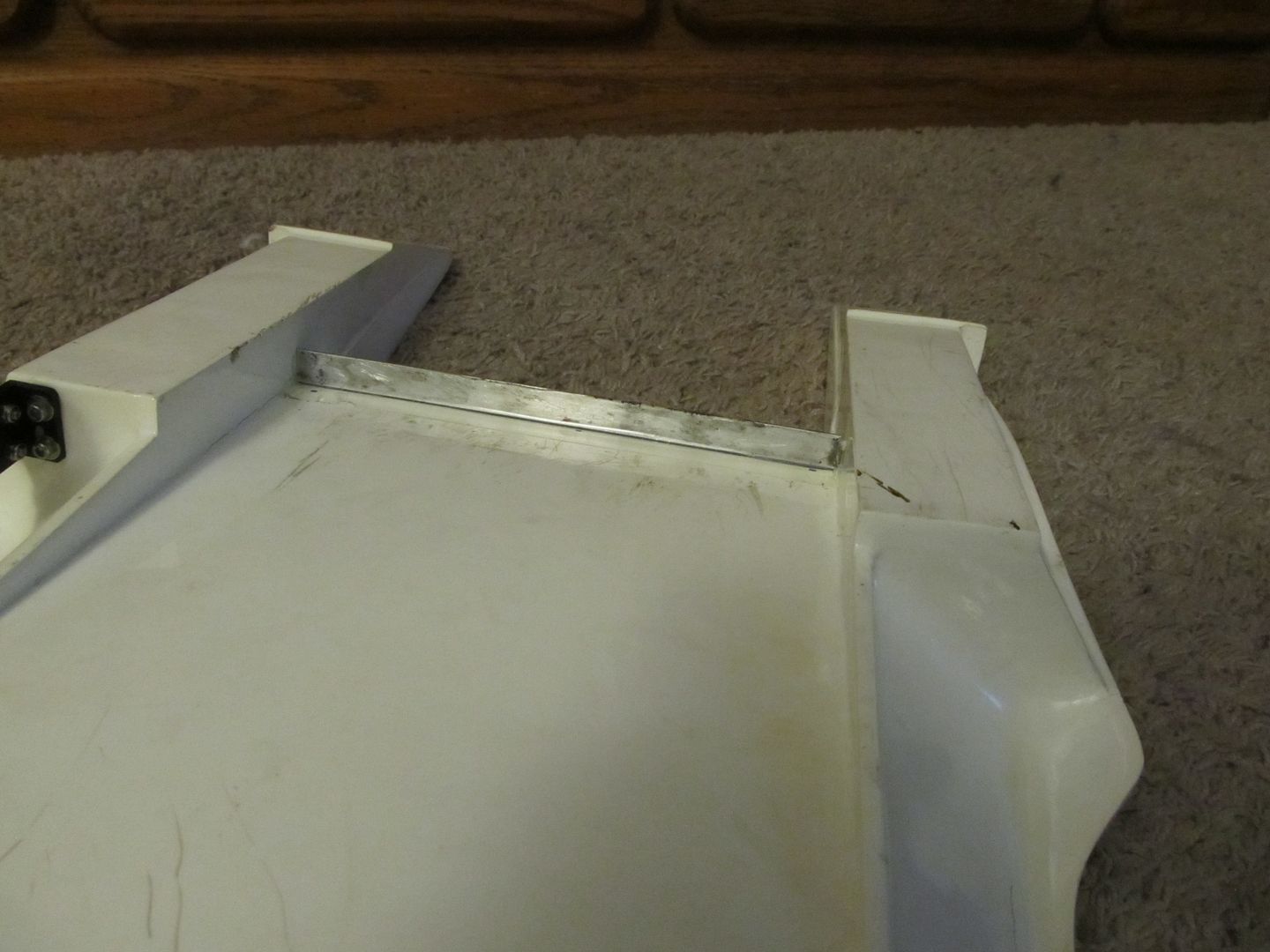

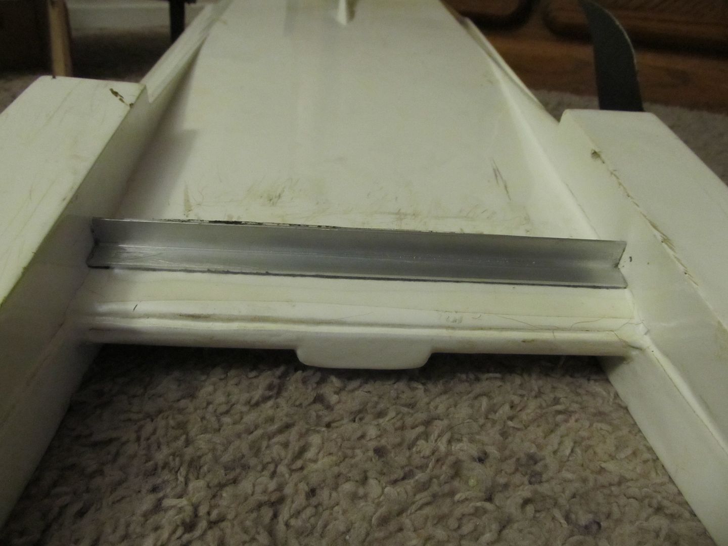

                      I've got an airdam on my UL-1 hydro, Electric is right, it really kills lift but it sure helps keep the nose down. I used a piece of 1/2" aluminum angle from homer depot. I cut it down to fit snug between the sponsors. I used the thin servo tape to anchor it, then used hatch tape to cover gap between hull & dam, front and rear, trimmed with an x-acto and it works great.
                        I put mine on just a few minutes ago. I already had one made up. Heres what I did

                            Perfect man, you even made it look good. Let us know how it goes.
                              Well I tried it out today. Flipped out the water several times. It's probably how high I have my prop angled. I should have tried before and after. Maybe I'll do that next weekend.
                              Heres a vid
                              What seemed to help the most was moving the batteries up towards the front. I still need to come down a little on the prop angle.
