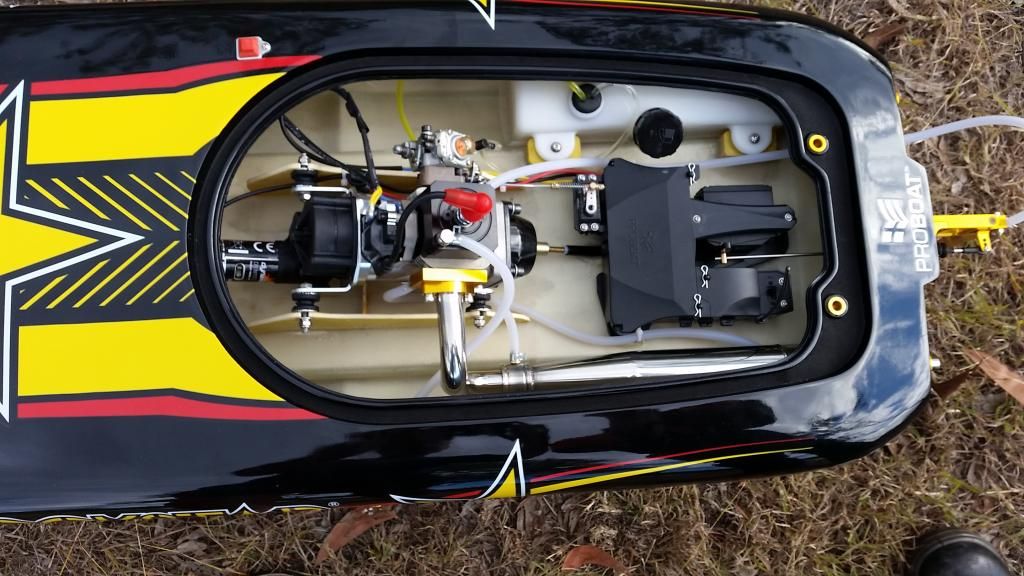

      It would be the same reason why all of the proboats were recalled world wide. The electrical start and control systems had failed. It controls everything from the starter motor--kill switch--steering--throttle and ignition. This is why we had to rip it all out and replace the starter with a manual zip start--A rewired kill switch--and run a power pack threw the receiver for the servos. Ive downloaded a pic of the electrical start system just b4 we gave it its 1st start up and run in. It was after its 1st run the electrics stuffed up (Happened on the work stand) The Aussie importer for PROBOAT said that they are going to give back some money for what has happened. Its a possibility that these wont be coming out with the push button electric start on them at all. He is happy with how the boat starts up using the pull starter (1 pull and its alive) and has always said that the electric starter didn't have enough power to crank it fast enough to make it fire into life the way it does now. Here are some more pics. The 1st shows the electric starter using a 15 turn brushed motor which has now been replaced by a Zenoah marine pull start and one way bearing with the correct end nut.

        So the ROS system has been binned for this boat now then?

                  Don't quote me on this everyone" If they are still going to come with all the features,they will have to totally rework the whole system. In other words its back to the drawing board.
