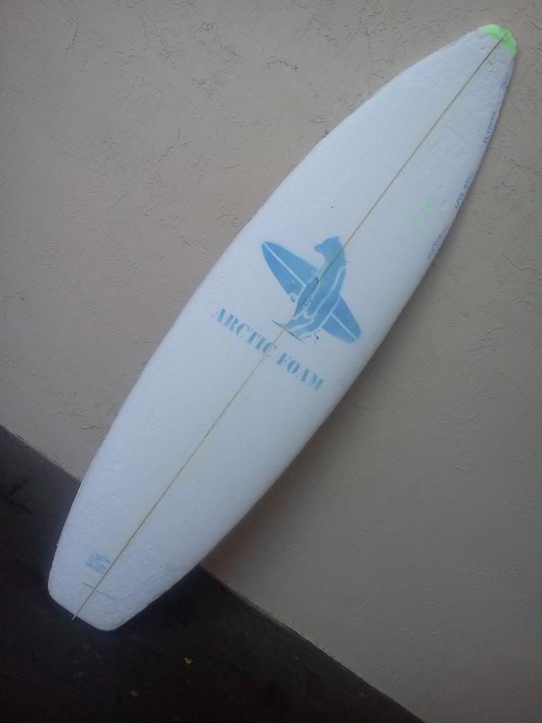

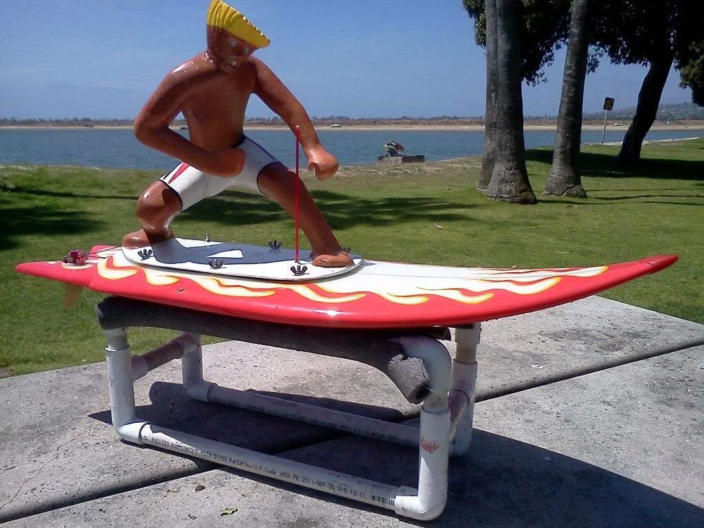

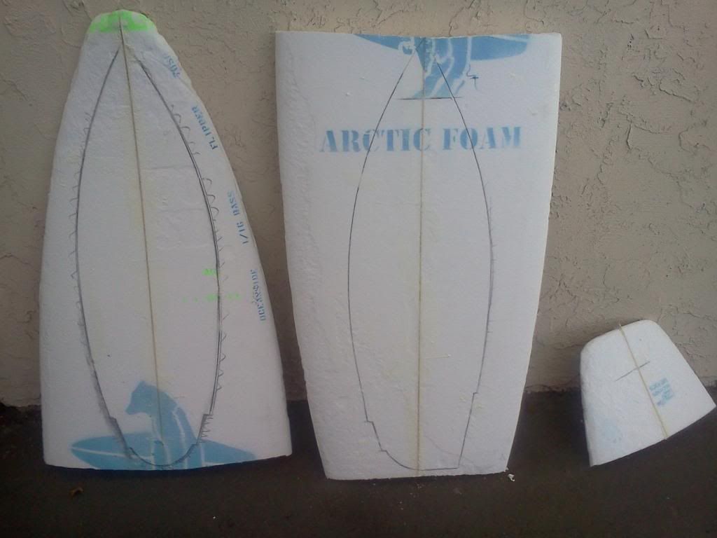

    I start with a Surfboard Blank...
    I can get Two boards out of the one blank
    60 hours later I can create one board and rider...

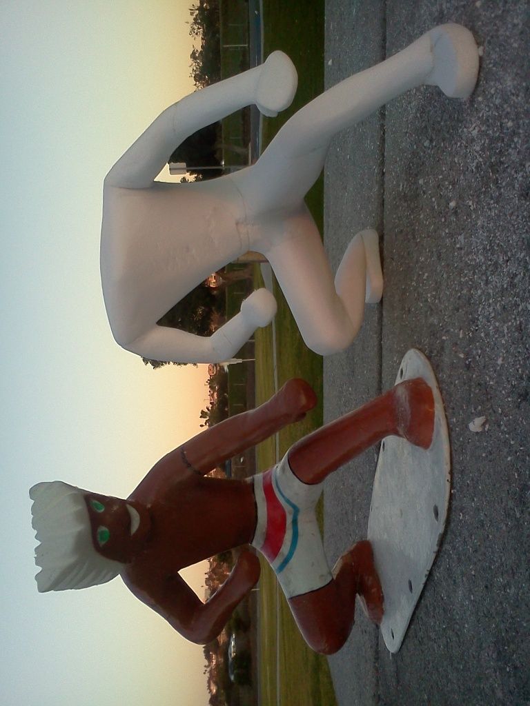

    yep! the Surfer himself has to be sculpted..
    I use scrap pieces of foam left over from the blank...glued together and then sanded, glassed, sanded. painted, and sanded some more...the figure takes about 20 hours.

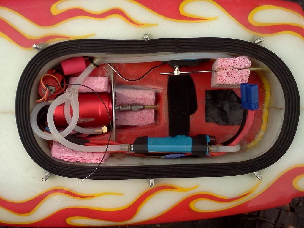

      Inside:
      Leopard 3674 1900kv running 5S
      Hifei Swordfish 120A ESC (sometimes I use the cheaper Aquastar version)
      water cooling...2 intakes(one for motor, other for ESC) 1 exhaust...i just started using this set up and it keeps everything a lot cooler.

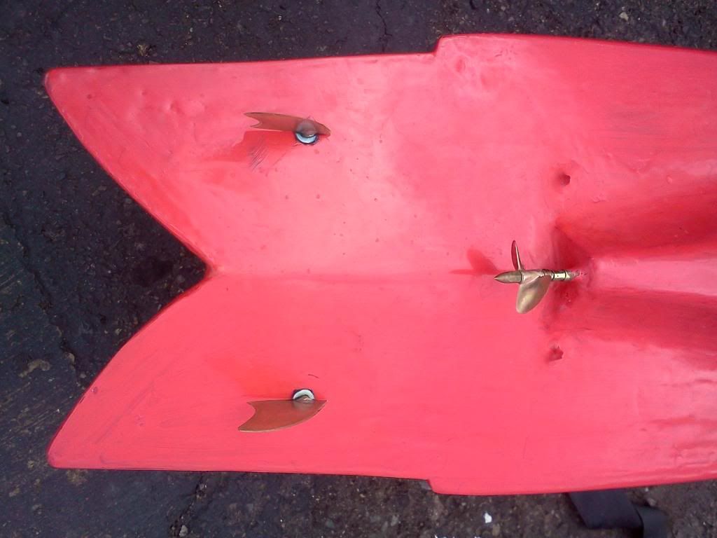

      .150 Flexi cable driving a Grim Racer 36 x 55mm prop
      Futaba BLS 451 Servo controlling Twin Steering Fins
      Fins were modeled after FCS Mr 78 Twin Fins

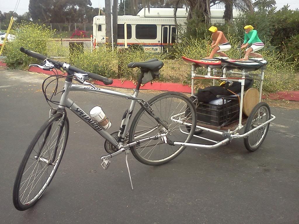

        I even remodeled a trailer to get to a couple of the spots we like to go...
        Here is a photo showing a Kyosho Production board c.2000 and the Surfers I am building today.
