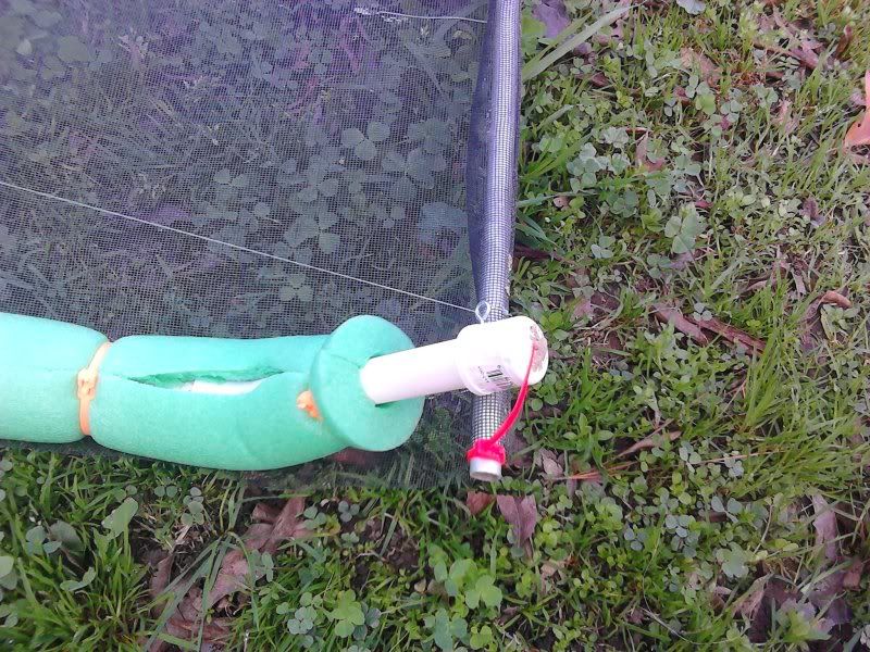

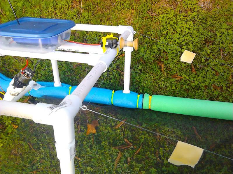

    What I have is a retrieval boat I made, its 20" wide, 36" long, and 12" tall. This was built for getting our nitro boats as it also works for my MiniMono, and a buddy's Traxxas Spartan. Its all PVC and floatation is the 6 foot float tube you can buy at pool supply places or WalGreens in the summer, has a 208 oz ebay/hobbyparts servo for a winch that has had the pot modified to continuously rotate. Running a stock 540 can motor and traxxas lipo friendly Esc, using a Hacked GT3B for the controller of all 3 channels, and 3 cell 2200mah battery to run it. Capture trap is window screen with a aluminum pipe at the front for pulling it up even with the winch. Not going to post to many details but if somebody wants to ask I will answer any questions on specs.

    Rudder is simply just a tricycle landing gear with the spring cut off and a shaped piece of metal silver soldered on, then a hole drilled straight down in pvc. Using the tricycle horn and bushings.
