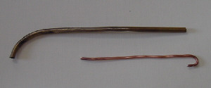

When making 90 degree bends I use a piece of home electrical wire and place in into the tubing before bending it. The wire will stop the tubing from getting a kink in it. I take my time and work the tubing slowly. I always make a hook in the end of the wire. It makes pulling the wire out, all the easier!
This is the finished product. With the annealing process I can almost make a pretzel out of it! When cutting the tubing, make sure to sand any shape edges. I had a sharp piece cut a hole in the rubber tubing of a boat. It took me two times to the pond to find the leak!
